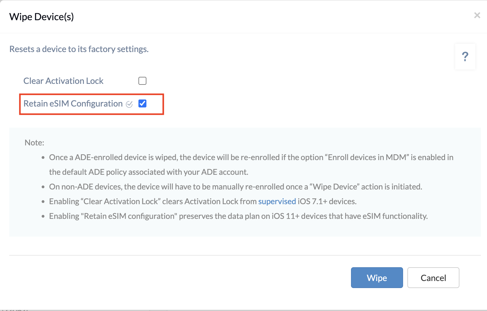

Hi @sybylla, welcome to Hexnode Connect!
Yes, it is possible to wipe your iOS device while retaining eSIM configuration. Here’s how to do so:
  1. On your Hexnode UEM console, navigate to the Manage tab.
  2. Select your device(s) from the list of devices and click on Actions.
  3. Choose Wipe Device action from the Actions dropdown list.
  4. Check the Retain eSIM Configuration option and click on Wipe.
  5. Wipe device action for iOS devices via Hexnode UEM console.
The device will be wiped while retaining eSIM configuration. This is applicable only for iOS devices running 11.0 and above.
For more information, check out our help document on Wipe Device action.
