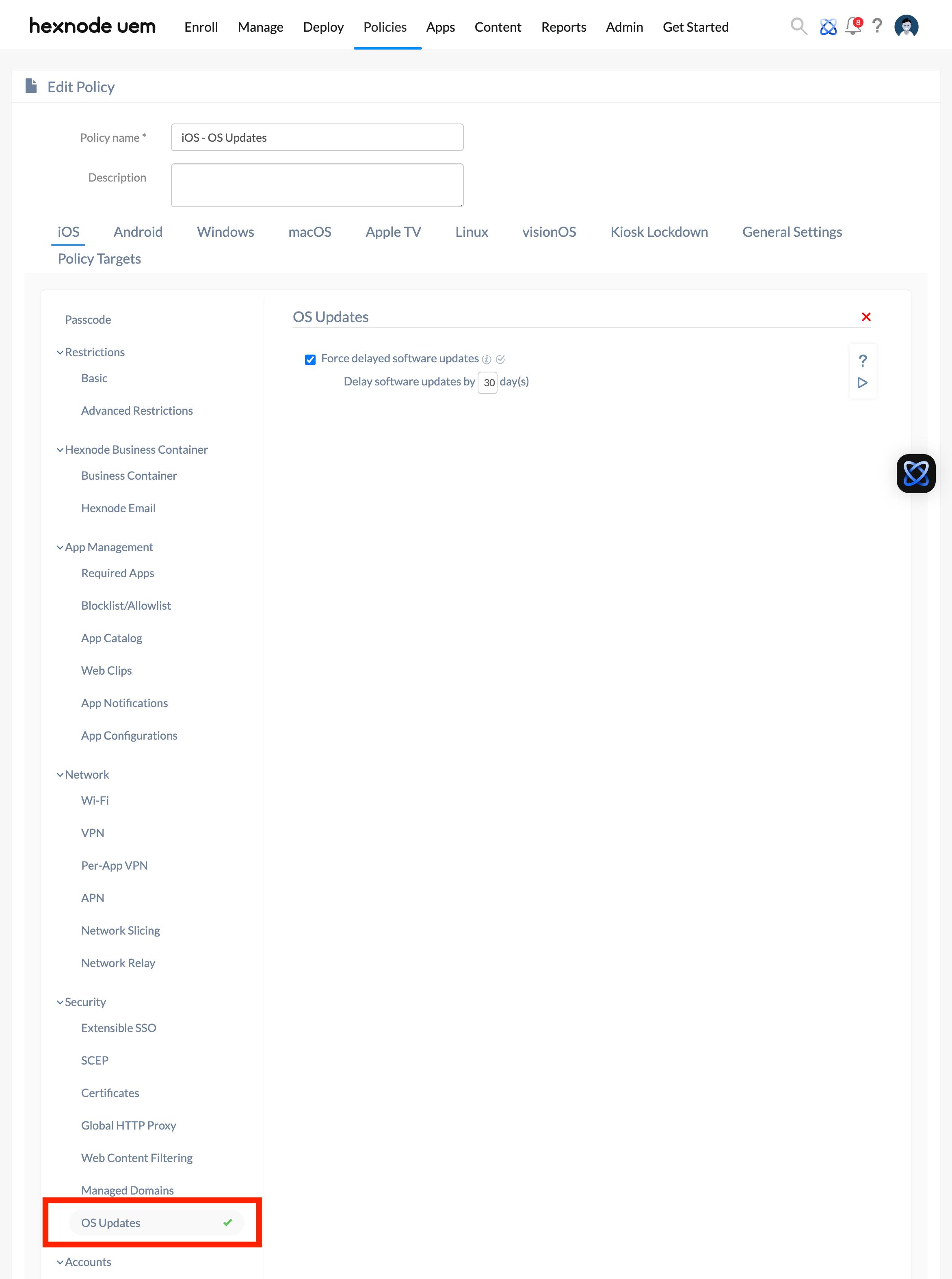

You can use Hexnode’s Force delayed software update option, available for iOS devices, to delay the updates. However, updates cannot be deferred based on type.
To delay the updates, you can follow these steps:
  1. On your Hexnode UEM console, navigate to Policies > New Policy.
  2. Provide a suitable policy name and description.
  3. Under iOS > OS Updates, click on Configure.
  4. Check the Force delayed software updates box and specify the number of days to delay updates. (0 – 90 days). The default delay is 30 days.
  5. Configuring OS Updates policy on iOS devices.
  6. Click Save and associate the policy with the device.
