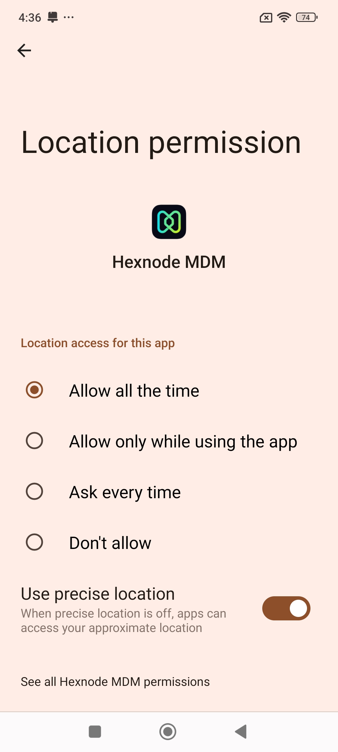

@luke , this issue is likely due to how the location permission for the Hexnode UEM app was granted during the enrollment process. If the permission was set to “Allow only while using the app” instead of “Allow all the time“, the device will fetch the Wi-Fi SSID only when the Hexnode UEM app is open. To ensure the SSID is fetched at all times, you have to make sure that the location permission for the Hexnode UEM app is set to “Allow all the time” during the enrollment process. To resolve this issue, I recommend that you re-enroll any devices for which the Wi-Fi SSID is not visible in the Hexnode portal.
Location permission for Hexnode UEM app.
