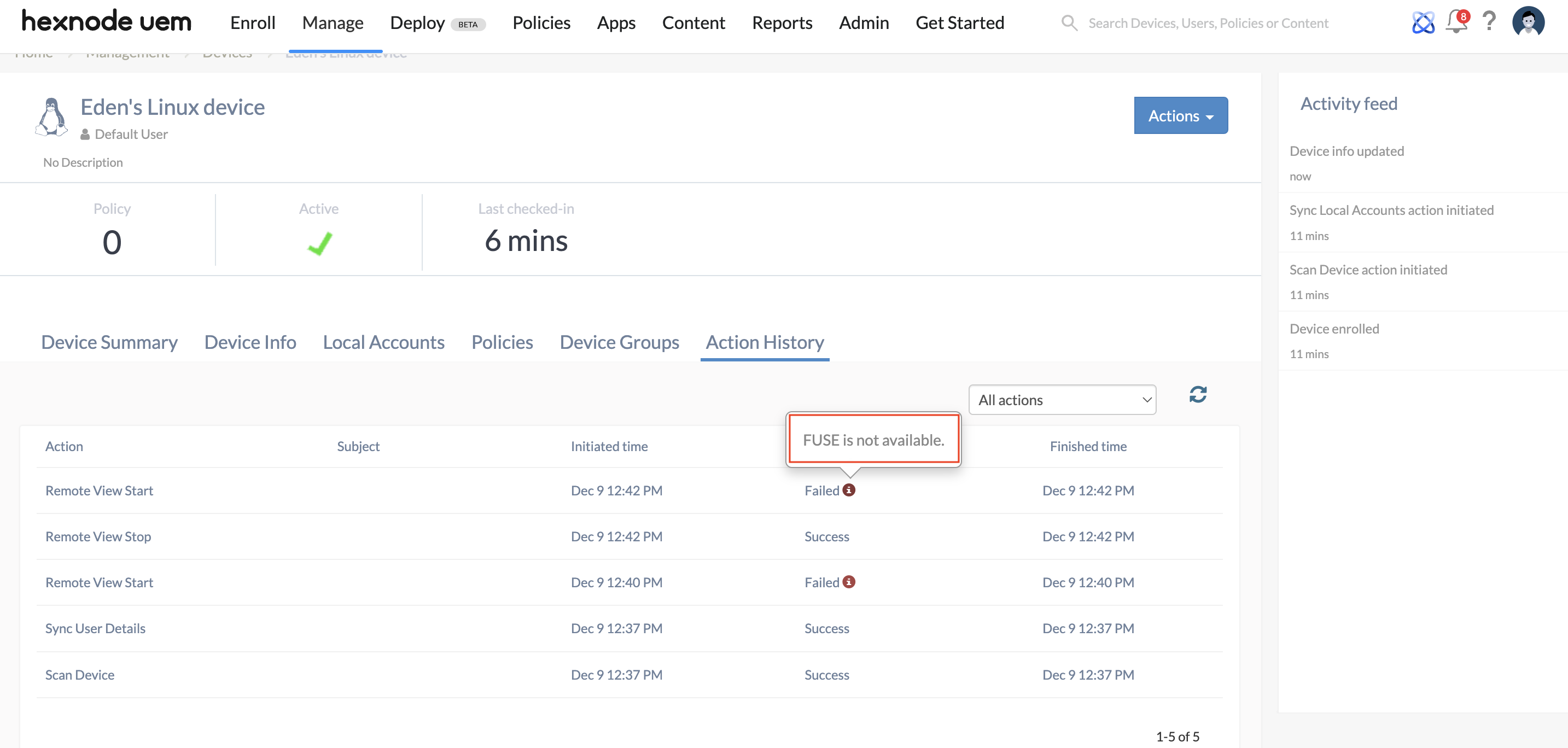

Hey, I’ve got a few Linux devices enrolled in Hexnode UEM. When I try using the Remote View feature, I keep getting this “FUSE is not available” error. Can someone help me out?
Action history showing the error message

Hi @mortimer! That error pops up because the FUSE library isn’t installed on your Linux devices.
The FUSE (Filesystem in Userspace) library, or libfuse, is a tool that enables non-privileged users to implement their own file systems on Unix-like operating systems (here Linux). It provides functionalities for mounting and unmounting file systems, handling requests from the kernel, and processing them efficiently. FUSE library is an essential component for the functioning of remote view and control feature on Linux devices managed through Hexnode UEM.
Here’s how you can fix the above mentioned issue:
Run the following command on your device’s terminal to install the FUSE library.
Note that the behavior of the terminal command may vary depending on your Linux distribution and version. Therefore, it’s recommended to test it in a controlled environment before executing it in bulk. This command has been tested successfully on Ubuntu 24.04.
Once FUSE is installed, you should be able to use the Remote View and Control feature without any issues.
