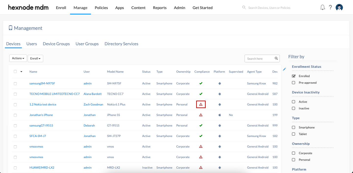

You can configure the general inactivity settings for your devices from under Admin > General Settings > Inactivity Settings. You can set the time period for Mark devices as inactive after as 15 minutes or set a duration that suit your needs. This will ensure the device syncs regularly with the portal. On the same page, also find Compliance Settings and enable mark your devices as “non-compliant” if Device becomes inactive. When the device becomes inactive you can see a Warning icon marking the device on the Devices list under Manage tab.
Warning icon shows for non-compliant devices on the device list under the Manage tab.

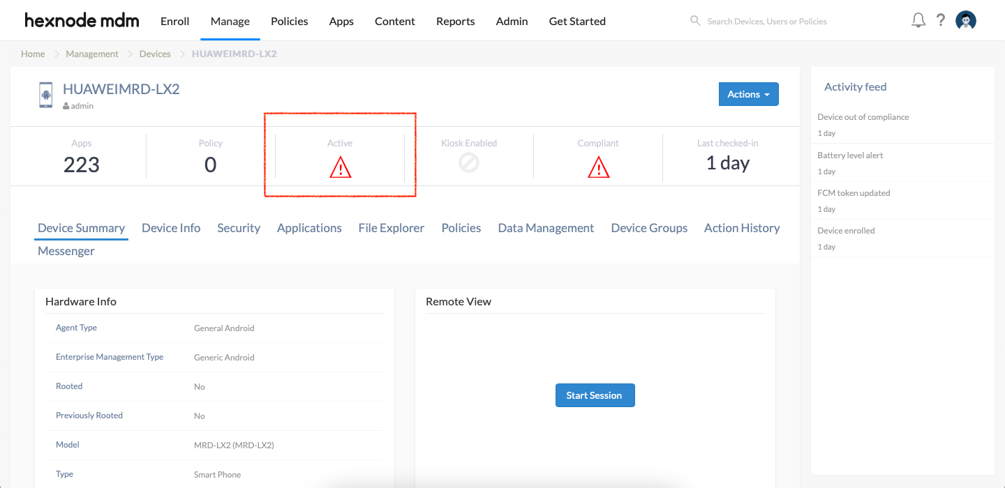

Note: On clicking the device name and opening the device page you’ll see another warning icon under Active status.
warning icon shows for inactive devices on the device summary page

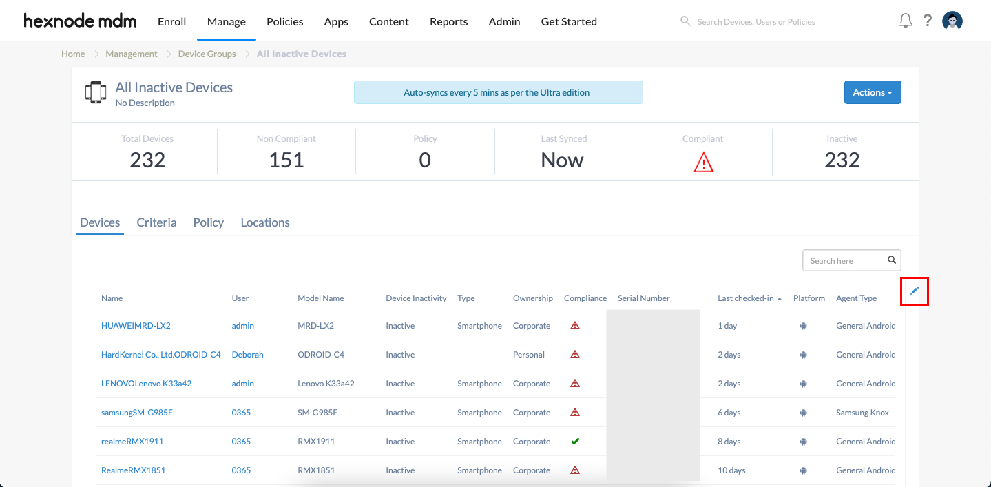

Note: To list all inactive devices in one place, you could use our dynamic grouping feature. Create the dynamic group from Manage > Device Groups by clicking New Dynamic Group. Name the group and set the condition filters as –
Column group: Compliance Info
Column: Device Status
Comparator: Is
Attribute: Inactive
Save the group by clicking Save Group. You’ll find the group listed under Manage > Device Groups. Open the group and customize the columns for the device list by clicking on the edit icon. Ensure to include Compliance and Battery Level columns. You can use this setup to monitor inactive devices from one place.
Click on the pen icon to edit the column for the device list
All devices in this group might not have a dead battery but rather a device network disconnection. You could also configure a dynamic device group for devices with battery level below a certain percentage. To do that, set the condition filters as –
