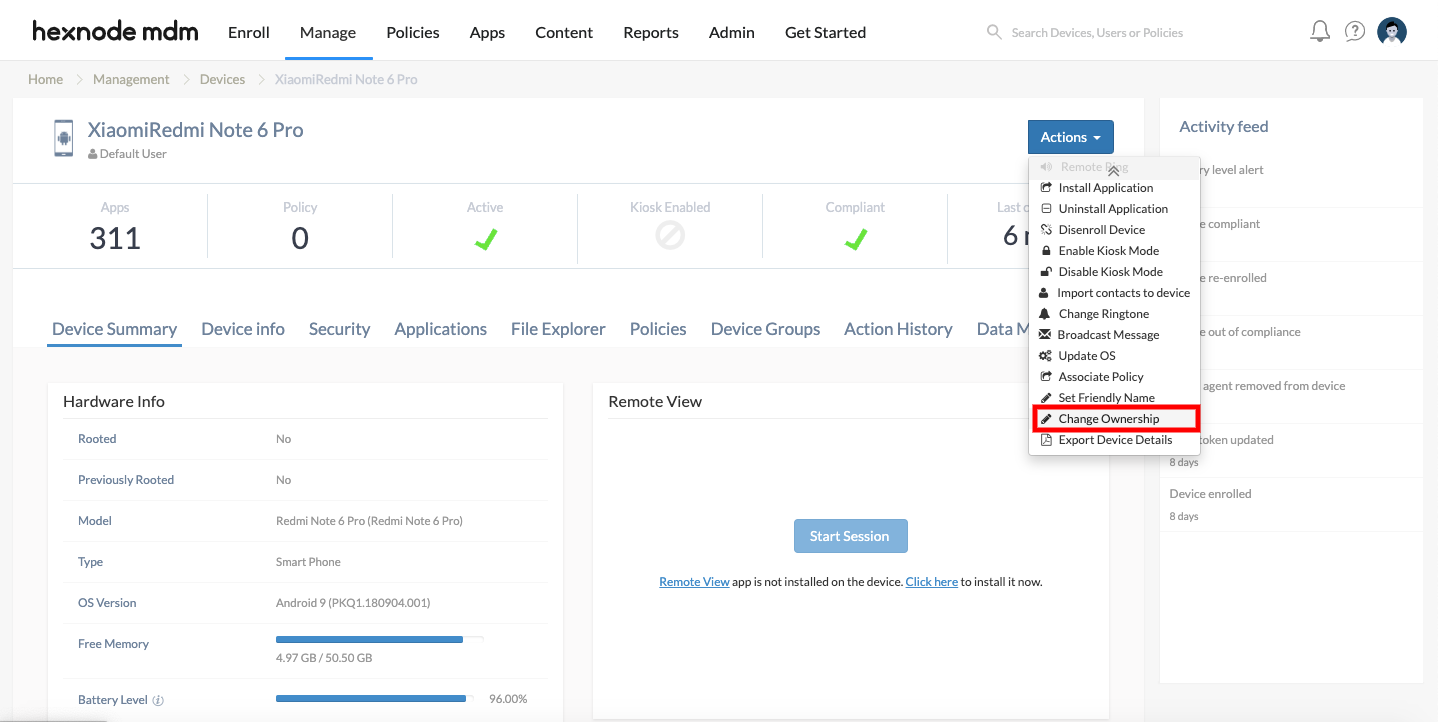

  1. Navigate to Manage > Devices > Select the device.
  2. From Actions, choose Change Ownership.
