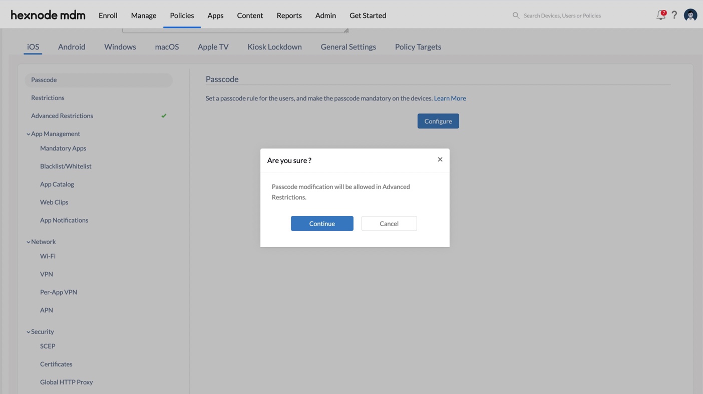

Hey so I was trying to set passcode policy and then restrict users from modifying passcode. But these messages popped up when I tried to do both. Could you explain why this might be happening?
5 years ago Mar 29, 2022
@verb You’ve got nothing to worry about! You see the message due to the conflict between the passcode policy and modification restriction. If you restrict modifying the passcode, no new passcode can be added. Henceforth, applying a passcode policy opposes restricting the passcode from being modified. Therefore, the error message pops up.
Configure the passcode and restriction in separate policies and apply as mentioned in the above replies, and you are good to go.
