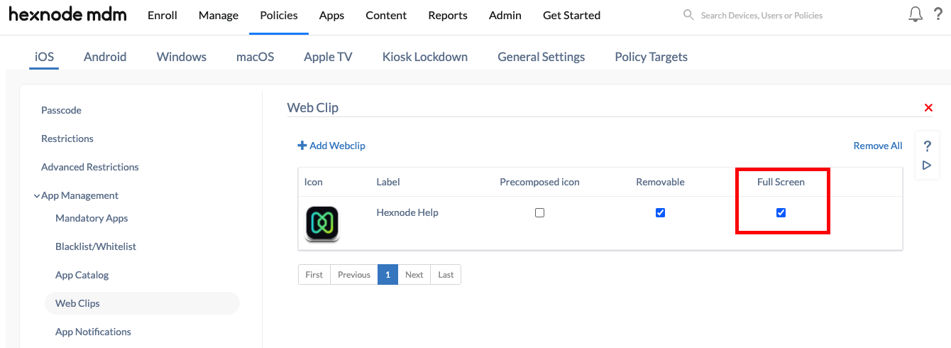

hey i deployed a web clip with a custom image for the icon but the app is coming with the website icon on the phone. why is that??
6 years ago Apr 07, 2021
Thanks for reaching out to us @Lois!
You may face this issue in some URLs due to Safari’s web icon rendering.  You can prevent this by choosing to open the app in full screen mode. In the Hexnode portal, navigate to Policies and open the associated policy. Under the iOS subtab, select Web Clips and check the Full Screen box against the web clip.
Configuring Full Screen option for Web Clip
Hope that helps.
