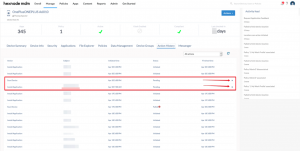

I have some action sent long ago, that are still pending. Is it possible to cancel this pending action sent to the device?
6 years ago Apr 22, 2021
Hi Aika,
An action that is deployed to a device can be stuck in the “pending” state due to various reasons. The most common reason would be of the device stuck in a state with no network connectivity, halting the Hexnode sync services.
You shall be able to cancel an action that has been sent to the device, if it remains in the pending state. For this, you shall have to click on the ‘x’ button which is present to the far right of your corresponding action. Please have a look at the image below:
