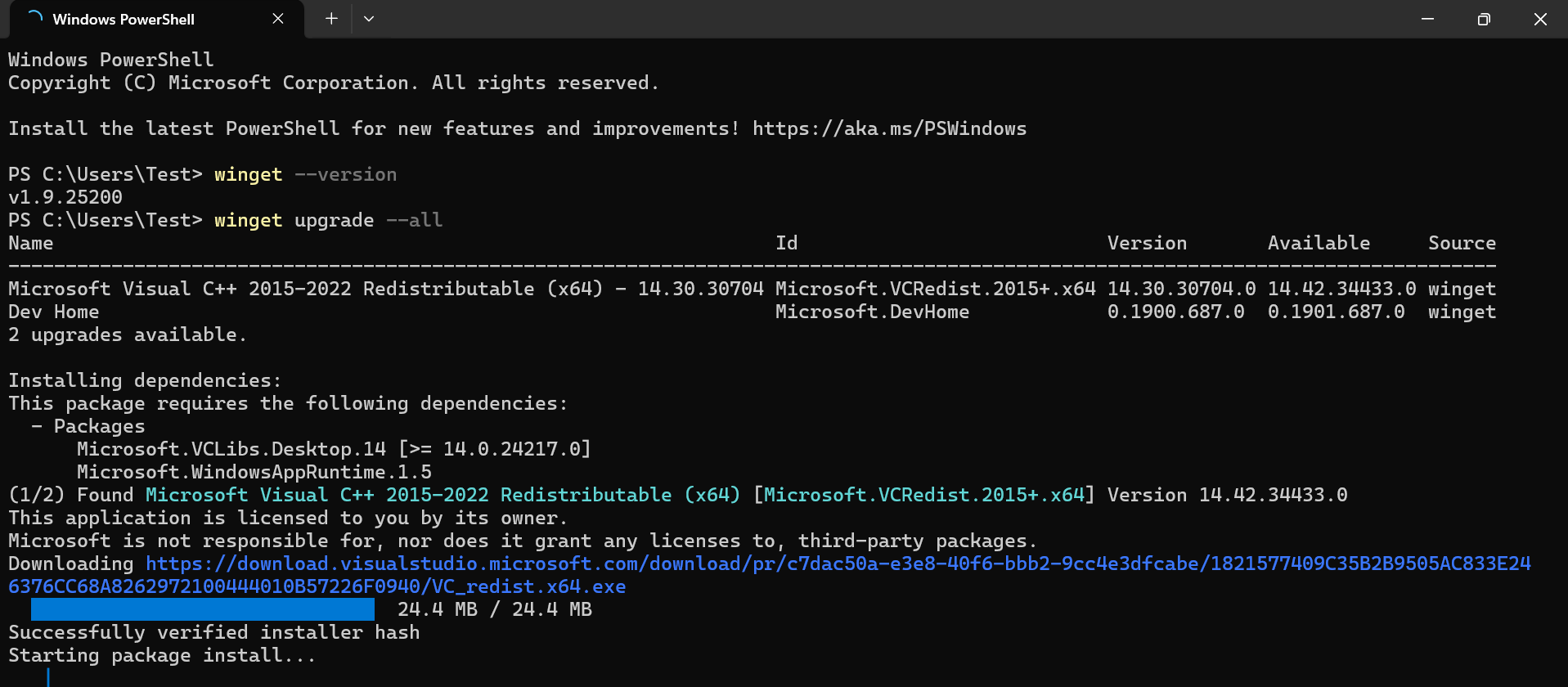

First, you’ll need to check if winget is installed on your device. You can do this by running the winget --version command in PowerShell. Once you have ensured that winget is installed, you can start using it to update your apps. You can run the command winget upgrade --all to update all the apps with available patches.
winget cmdlet running in Powershell on Windows device.
