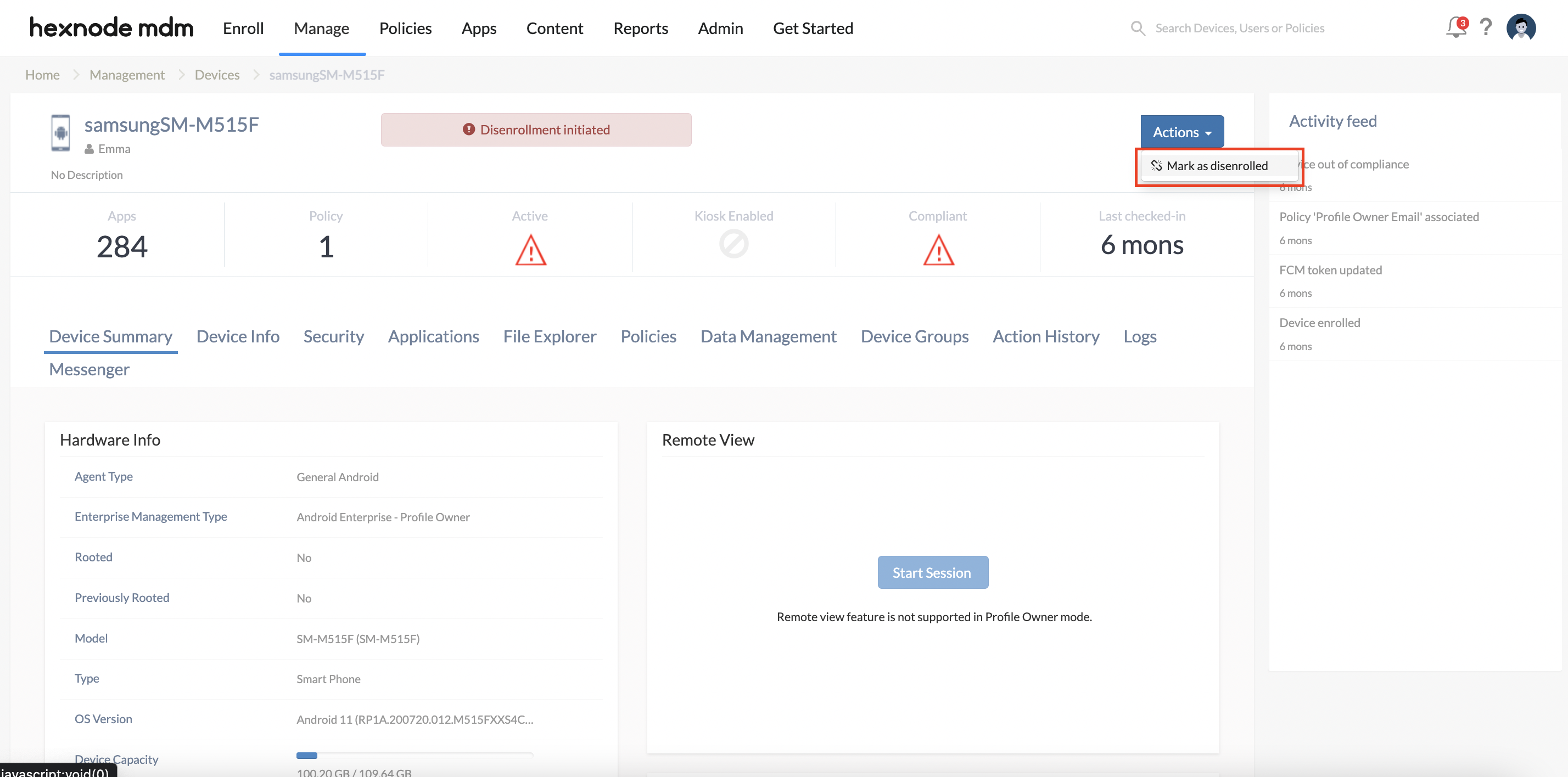

You can disenroll the devices you no longer use and remove them from the list displayed in the Hexnode UEM portal. All you’ve got to do is navigate to the Manage tab and select the device you want to disenroll. Then, select Disenroll Device from the Actions drop-down.
Once the Disenrollment initiated banner is displayed, select Mark as disenrolled from the Actions drop-down.
mark device as disenrolled to remove from the portal
