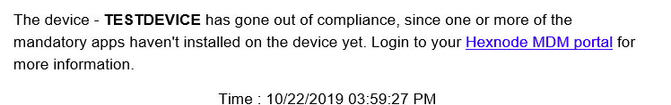

When I receive emails about out of compliance devices the time is way off. How do I adjust the time when receiving email notifications?
Ok this is for iOS notifications. I wanted to change the time on the email notifications that arrive in my inbox when a device is out of compliance.
That email arrived around 11am but sats 3:59pm

You will able to select the time zone for the reports from the Hexnode portal itself.
To select the time zone:
  1. Navigate to Admin-> General Settings-> Time zone settings for the Reports.
  2. Click on the drop-down list next to the option Select your Time zone and choose the desired time zone.
  3. Click Save.
The reports from now on will display the time as per the chosen time zone.
