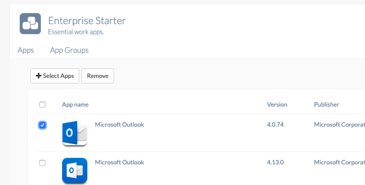

To remove the app from the catalog, please follow the below steps:
- Go to Apps–>App catalog.
- Click on the desired catalog.
- Select the App to be removed.
- Click on the remove button.
Use the below screenshot for a reference:
You can open the Hexnode MDM app and check the Catalog to ensure that the app has been removed.
